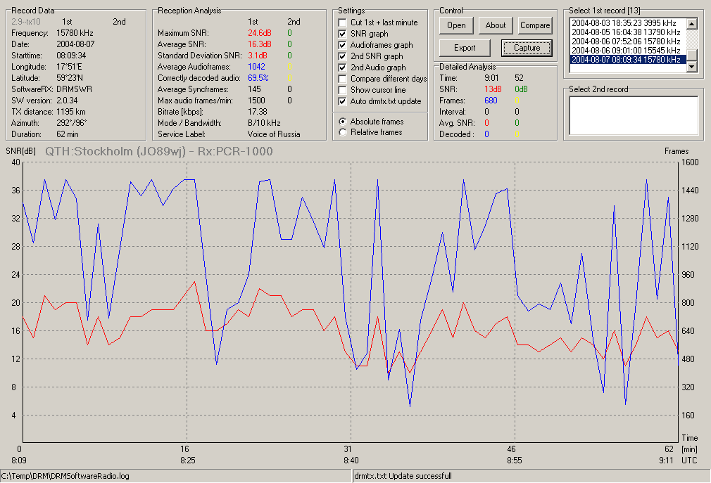

              Hi Andrew + all,
              Yes, if I look at the coverage map I'm clearly not in the target area. So I persume that the signal in my location is much weaker than in beam center.
              Today provided a similar result as previous days: 70%. Listening time: 08:00 - 09:10 UTC.
              73's Per - SM0ITS

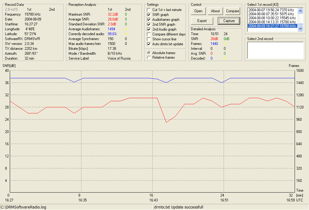

                Hi Andrew,
                I tuned in again this morning, better than last time, at least I could listen to the German service in the last 15min, see attachment
                73, Simone

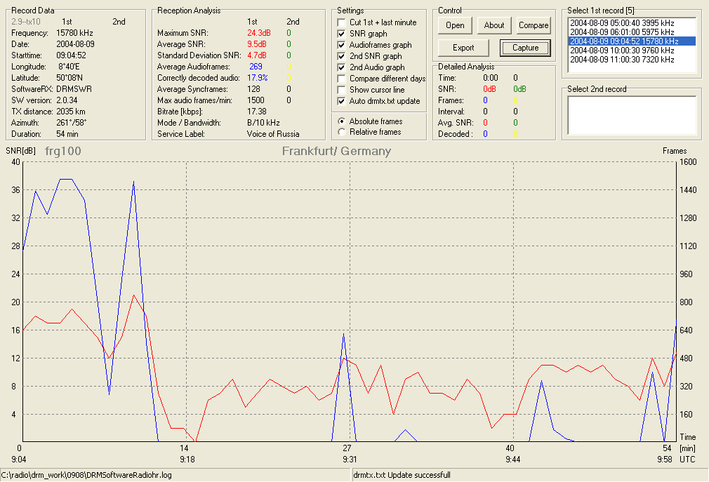

                        #71
                        Hi Andrew,
                        unfortunately no improvement of the results, see attachment
                        73, Simone

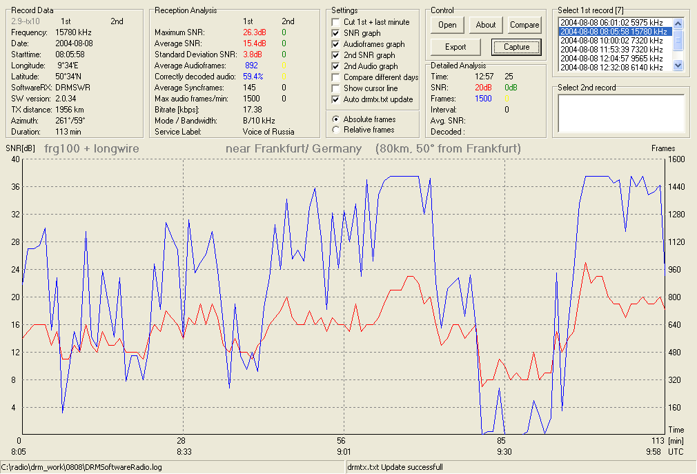

                            Hi Andrew,
                            here is a spectrum plot showing the heavy interference from 15785 kHz at 08:15 UTC today.
                            Very bad reception as a result.
                            Even the new bandpass filter in Dream does not help.
                            dk8cb

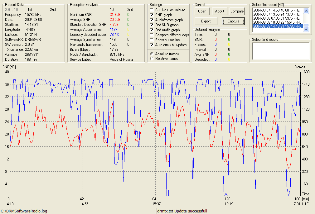

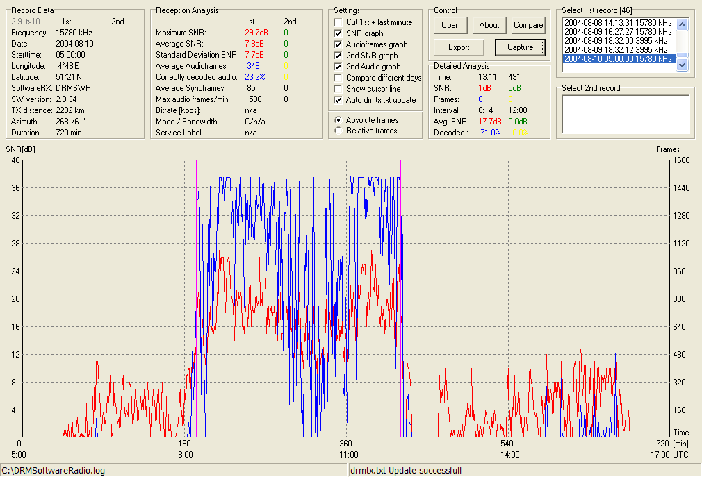

                              Hi Andrew,
                              We had our receiver monitor your frequency a full 12 hours and enclosed is the result.
                              During the period 0814-1200 UTC the signal was quite acceptable with a 71% audio, but during other times, reception was nil, also in the afternoon transmission. A big difference to yesterday's early evening reception.
                              Hope the log is of some use.
                              Ludo
